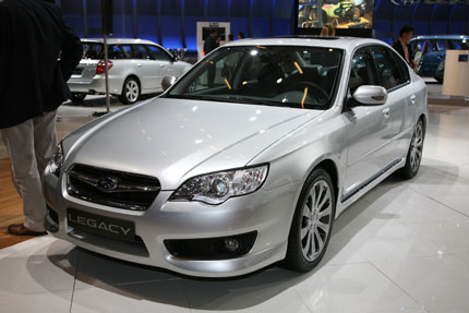

Evo, še en link o dieslčku pa legacy razstavljen na pariškem salonu.
Subaru has put together a modest refresh for the Subaru Legacy and Outback sedans and wagons. European buyers will enjoy the benefits starting next month, while we'll see something like it starting with the 2008 model year.
http://blogs.edmunds.com/Straightline/c ... cat.Subaru
:uzfuzf kok je huuuuuuuuuuud :cool: :-P :D
