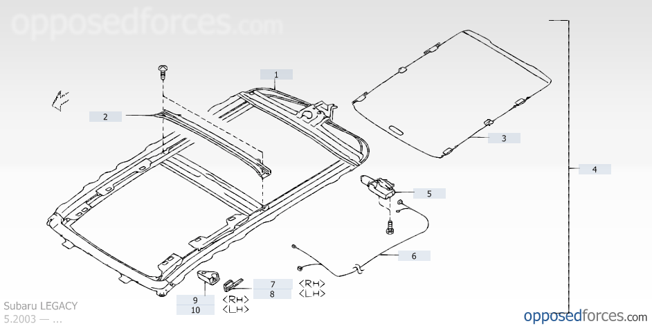

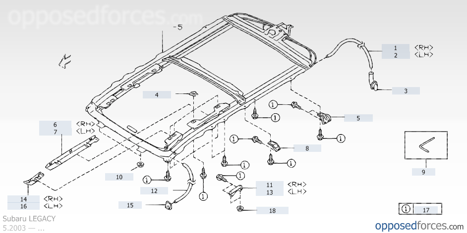

Znaš iz teh diagramov razbrati, kateri del rabiš?
http://static.opposedforces.com/epc_img ... 165404.png
http://static.opposedforces.com/epc_img ... 165405.png
