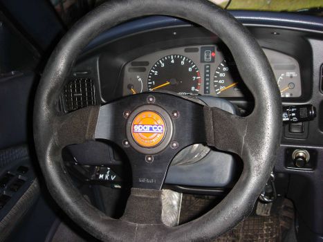

Odgovor Avtor: Thomas22 » 13. December 2006, 00:36
Jaz sem v starejši model Legacyja namontiral Momota:
http://www.subaru-slo.net/userpix/110_LegacyVolan_1.jpg
