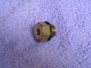

Zanimiva informacija:
http://www.subaru-slo.net/userpix/110_379_1_1.jpg
Sender fitting adaptor
Model: All Subarus
Regarded as most to be the ideal place to fit an oil temperature sender is above number 3 cylinder, for many reasons this is the cylinder that runs the hottest and in 9 out of 10 cases will be the cylinder that causes engine failure. Simply remove the blanking plug that Subaru so kindly fitted and replace it with this adaptor which will allow the fitting of a 1/8th npt sender unit.
Kater pa je tretji cilinder in ali je kdo že videl ta čep?

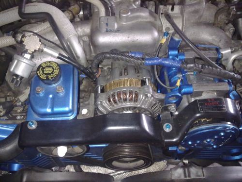

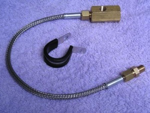

Na takle način pa sem jaz montiral senzor za pritisk olja:
http://www.subaru-slo.net/userpix/110_378_1_1.jpg
This piece of kit is essential for fitting an oil pressure sender when you do not wish to use a sandwich plate. Because the OE oil pressure switch is located under the alternator it is impossible to fit an oil pressure sender and retain the original switch. With this remote unit you simply remove the OE switch and replace it with the 30cm stainless braided pipe, position the sender block in your desired position and then fit the OE switch and your new pressure sender to it.
Odgovor Avtor: gorazd0 » 21. Avgust 2009, 00:22
tretji cilinder (je res problematičen,.. tko kot 4 (njegov( ležaj na glavni gredi) je na sovoznikovi strani, pri požarni steni;

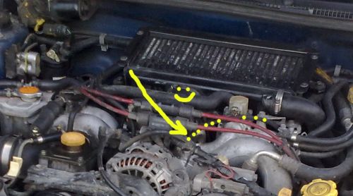

irCAR81 napisal/-a:Če hočeš vezat tako kot je na prejšnji slikci rabiš t-člen.
Lahko pa vežeš tako kot sem imel jaz. Cevka označena s pikicami vodi v kabino.http://www.subaru-slo.net/userpix/19_boost_2.jpg
iRcar, tale cevka, ki si jo označil mi ni jasna. Kot sem gledal tega turbaki nimajo.
Tule se lepo vidi kje na sesalnem kolektorju so 3 cevke bela, zraven črna - piše "boost" in še ena črna).
http://www.subaru-slo.net/userpix/110_T ... ervo_1.jpg
Sem gledal pri Psssihotu in je imel priklopljen boost tam kjer sem označil (na srednji cevki). Beliblisk, pa ima priklopljenega na desni cevki, ki gre na blow-off ventil. Torej katera cevka je prava?
Mogoče ima Beliblisk zato tam, ker ima možnost nastavljati tlak.

DaviiD
Prispevki: 244
Odgovor Avtor: DaviiD » 18. September 2010, 22:41
Vseeno je na katero od teh treh cevk priklopis... Jaz mislim da imam na skrajno levi, nisem pa ziher...
Odgovor Avtor: Thomas22 » 18. September 2010, 23:15
Tisti, ki gre na blow off?
Prispevki: 4138
Odgovor Avtor: strumf666 » 19. September 2010, 06:25
Cevka, ki krmili blow off gre iz sesalnega kolektorja, pa še par je takih (na fpr, MAP in boost solenoid). Načeloma je čisto vseeno, na katero daš T razdelilec, ker je cel sistem pod istim tlakom, mogoče imaš pa tudi kak priključek na sesalcu viška (zablindiran), pa ga lahko uporabiš.
